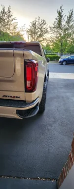

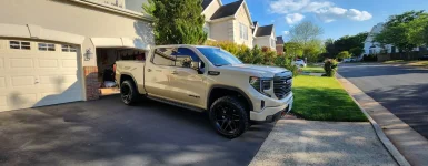

2022 1500 AT4x
Wheels: Fuel Flux -18 offset, 4.5 backspacing
Tires: LT285-50-22 Nitto Recon Grappler
Suspension: Stock
Note: Needed minor plastic trimming and has a slight rub occassionally at full turn. As you can see from the pics this wheel and tire combo can be done No spacers, and the tires stick out about 1.5" from the fenders

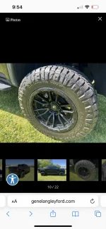

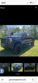

Question for everyone. I’m in process of looking for AT4. I’m trading in Ram TRX. Anyway, I’ve found a 2022 with the 4" Rough Country Lift with Vertex Adjustable Front Coilovers and Vertex Adjustable Rear Shocks. It has 20” (not sure specs) Fuel Rebels with 37x12.50x20 Ridge Grapplers. I am a good 2 hour drive from truck so can’t see in person. Is this setup liable to be rubbing pretty bad? The sales lady I initially spoke with really is not sure what I’m talking about. Any help is greatly appreciated! Here’s a pic of truck.

But, this picture here, I swear it looks like a 35x12.50x20. I asked her to double check and she says 37x12.50x20. Also, supposedly the previous owner left this list of mods to the truck and it says 37”.

Well, mystery solved! They ARE 35’s! It’s crazy that the owner got it wrong, haha.
With that said, would the 35’s prob be rubbing? Looks like a (-) offset wheel.

To answer your original question, you shouldn't have any rubbing issues with 35's with the 4" lift. I am using a 2" leveling kit in the front and run 35's. I did some trimming and a mudflap bracket removal and the rubbing is no longer an issue, so you should be clear with a 4".
If your new question is to get everyone's opinion on the type of lift and people style preferences, be ready for a long list of dissenting views. Just my $0.02 on that.
