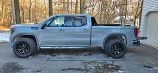

Finally snagged some high clearance steps for a good price. Gonna be on the lookout for factory elevation gloss black 20s and go with 275/65 tires. Not sure if I’ll stick with ridge grapplers or get ko3s.
