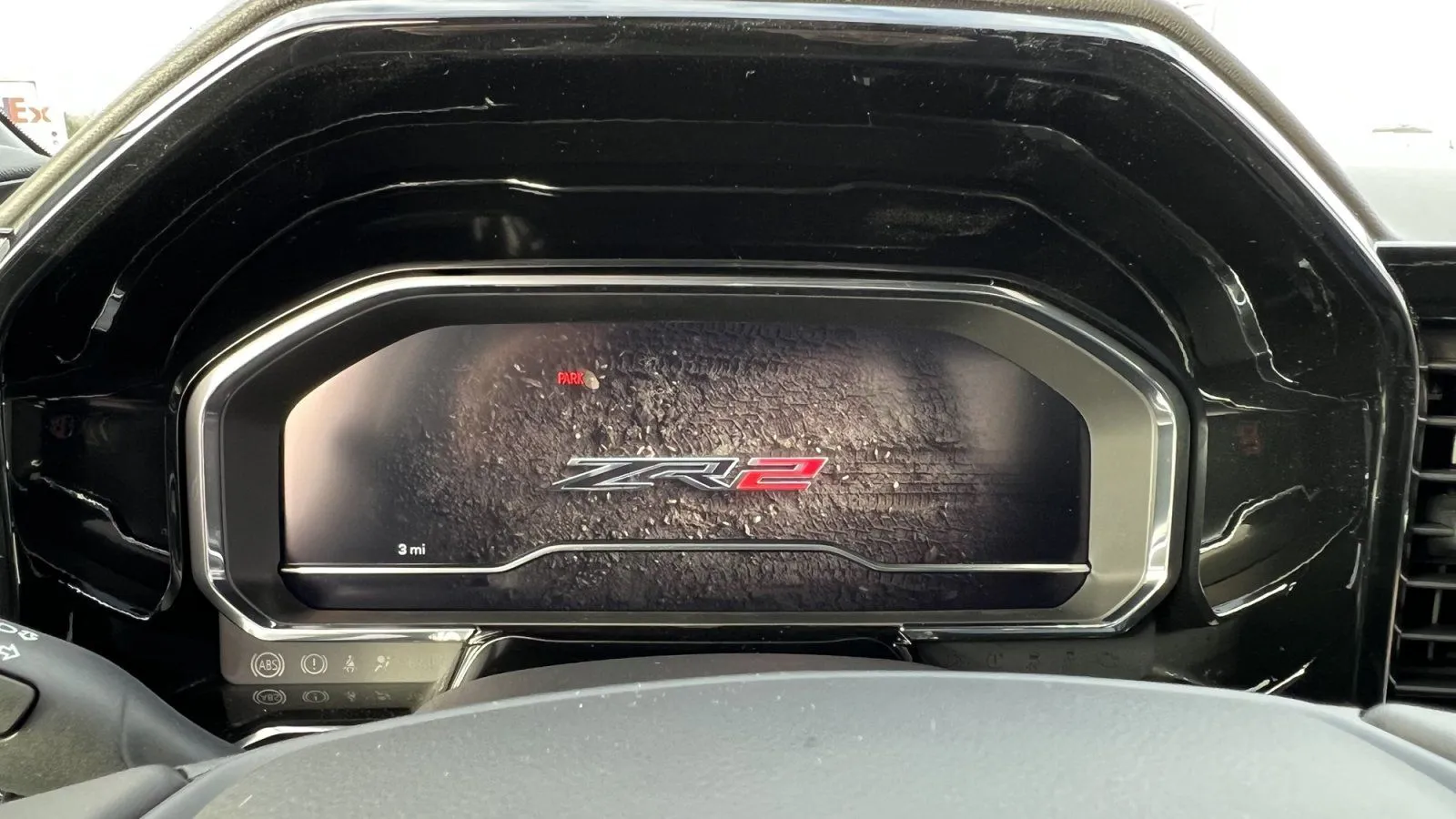

This thread from the zr2 forum has similar stories . Apparently this labor code 2810195 is key to getting to the update . However not all dealership actually understand how to get the new graphics file.
Here is the cluster update they installed that was supposed to work . I think there is an extra step about finding a graphics file that they are missing.

Apparently the zr2 guys are getting over the air graphic updates for this startup animation issue . Happened last week to a member with a 2022.
Some things I've noticed about the new software update is the instrument panel icons are slightly different and the fuel iconomy is now "live" meaning as I accelerate it goes down and when I let off the gas it goes up in real time. Before it was just the average and barely changed in days time. Thought I'd mention these changes.
My '23 AT4X received an over-the-air update earlier today and now I have the AT4X graphic in the instrument cluster. My truck was built in October and it had the AT4 graphic prior to today's OTA update.
