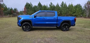

Run 35” tires with leveling kit

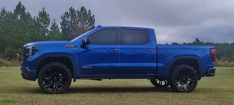

This before and after the Redi-lift leveling. 35x12.5r18 Nitto Recon Grapplers
I’ve been running 35x12.50-R24 on 24x10 factory replicas with no lift at all. I had to do a little trimming as others have mentioned. Cut the inside of the mud flap and removed the mud flap bracket. Had to cut maybe a half inch off the very bottom corner of front bumper. Just the black plastic part. Can turn full lock to lock with no scrubbing. I recently installed a leveling kit just to get the rake out but didn’t see where I gained much more tire clearance. Pic is before the leveling kit was added.
Great to hear. Can you share your exact make/model of your tire spec so people can look it up? Also exact specs of your wheels so people can look up offset and backspace too?
Thank you. Truck looks good
I’m running 35x12.50R24 Gladiator X-Comp M/T
Wheels are 24x10 Split Sevens (They are GM factory replica wheels that I believe were offered on the Escalades but in 22”)
They are +24 offset with 6.44” backspacing.
I am running 1/4” spacers because they were extremely close to the brake calipers and really close to the new upper control arms after installing the leveling kit.
These pics are with 1.75” Rough Country leveling kit.
You won't fit 35's on 12 in wide wheels with a front level. GMC's boxy wheel wells really hamper increasing wheel size. I have a 1.5" RC front level on my 23 AT4X, and running 34" tires on 20x10 -19 offset Fuel wheels. I have trimmed quite a bit, taken out the support metal block behind the splash guard of the back of the front wheel wells, and I still have a little bit of rubbing at full locks or when turing sharply and going over bumps or inclines. The offset is very important on tires rubbing or not, but on 12" wide wheels, even with a zero offset you are still protruding out far enough to rub. I would think 12" wheels would need spacers to clear the UCA's or other things also.
