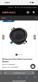

There are 3 speaker in dash and 1 tweeter in each of the A Pillars. Speakers in front doors are single cone….

The center speaker in the dash is not really for music. It's for your chimes, telephone, navigation, etc. You have the same front stage as everyone else, even with the "12 speaker" kit. GM considers the panel exciters for ANC as speakers and there are 4 of them. They are NOT speakers though. I love the theory behind ANC, but it is the ENEMY of a great sound system.

All my chimes, signal sound and all come from far left speaker (I covered each one as a test) ..so of the 5 separate speaker enclosures n the dash and a-pillar - I can hear (audio) sound out of all but the middle….

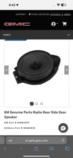

I sound deadened all 4 doors - used black hole matting and blocks inside door panels and sound skin under door panel (custom cut for GMC by Sound Skins), added matting to door panel plastic of each door panel and then used small pieces or matting at each clip to keep them
from rattling.
Replaced rear door speakers with BLAM coaxial 6.5” speakers.
Just the sound deadening changed the whole dynamic of the system - actually has some bass now, and no more door rattles or hallow sounding tin - and doors close with a solid feel now.
Next steps will be replacing a-pillar tweeters and r and l dash speakers with BLAM products as well. Current a-pillar tweeters are over-driven and crackle very easily.
Stil need to deaden back wall and install sounds good stereo’s amp rack. Will deaden floors along the way.
