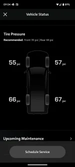

It can be done! Pissed they confused front and rear numbers.
