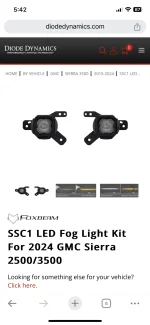

Diode Dynamics released these recently. They are on my to do list.

I need to read about these; will they fit a 1500 with the AEV bumper? I have a good friend that works for Diode here in St. Louis. I’ll ask him if I cannot find the info.
They should fit the AEV bumper only. They will not fit the OEM GMC bumper with the square fog lights. I ordered mine the first day they came out and they should ship out on the 27th. Once I install them I will provide pics and advice. I already posted about this here. Please note, I do not know if these will fit the 2500's. I think Diode Dynamics said this was for the 1500's.
Thanks. I emailed my buddy at Diode about these. Following your other thread!
My buddy from Diode Dynamics sent this fitment list from their website; Foxbeams makes the brackets, Diode makes the lights.
He also confirmed that since the 2022+ 1500 AT4X only comes with the AEV bumper, that they are made for that bumper only (on the 1500).
