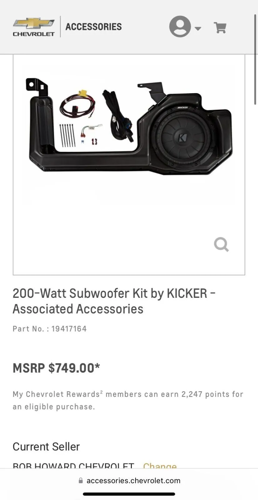

Decided on the GM Kicker sub
Found this on the interwebz. I'm going to check it out tomorrow.
I read through it. Basically confirmed what I was saying. Some think it adds nothing. But it seems with the knob installed there is a consensus it makes a difference. Also people agree change out BOSE speakers seem to help too. I think it is a good add on and has plenty of bass. I think if you want bass to move your truck and those around you this is not for you. My wife says it’s plenty loud and is happy. Its a hearing taste like exhaust in these trucks we all have a preference. I like GM Borla touring NOT ATAK.

That’s what I like to hear! I just want to know if it will be worth it since here in Canada it’s 1k for the sub lol
