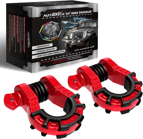

Shackle pin is like 7/8" while the towhook hole is 1 1/8". Additionally the shackle mounting width is less than towhook width 1 3/10" aka at least 1 1/8" . Is this specific to the AEV or it is standard on 2500 AT4X. I may need shackles with a 1" pin and somewhat wider mounting width. Experts, please chime in; which shackles do I need here?

AEV stated the towhooks were designed for soft Shackles. However I went with these and they fit nicely. Unsure if the measurements are different from the 1500 vs the 2500. I still have soft shakles, kinetic recovery ropes, and additional hard shackles if needed. If you want, I can give you a list of what i have packed out, and experience using.

I think you would have a 7/8" pin which is same size as one I received from Gear America, it would be very loose in my AEV which 'may' have a larger tow hook size. I'm waiting to hear from Bookendemo who has same truck as mine. I'm no expert on this stuff.

Did your shackles come with isolator? The isolaters help keep the shackles stiff on the bumper mount, and also keep them quiet so the don't rattle around. I'll send you a private message with that list.
