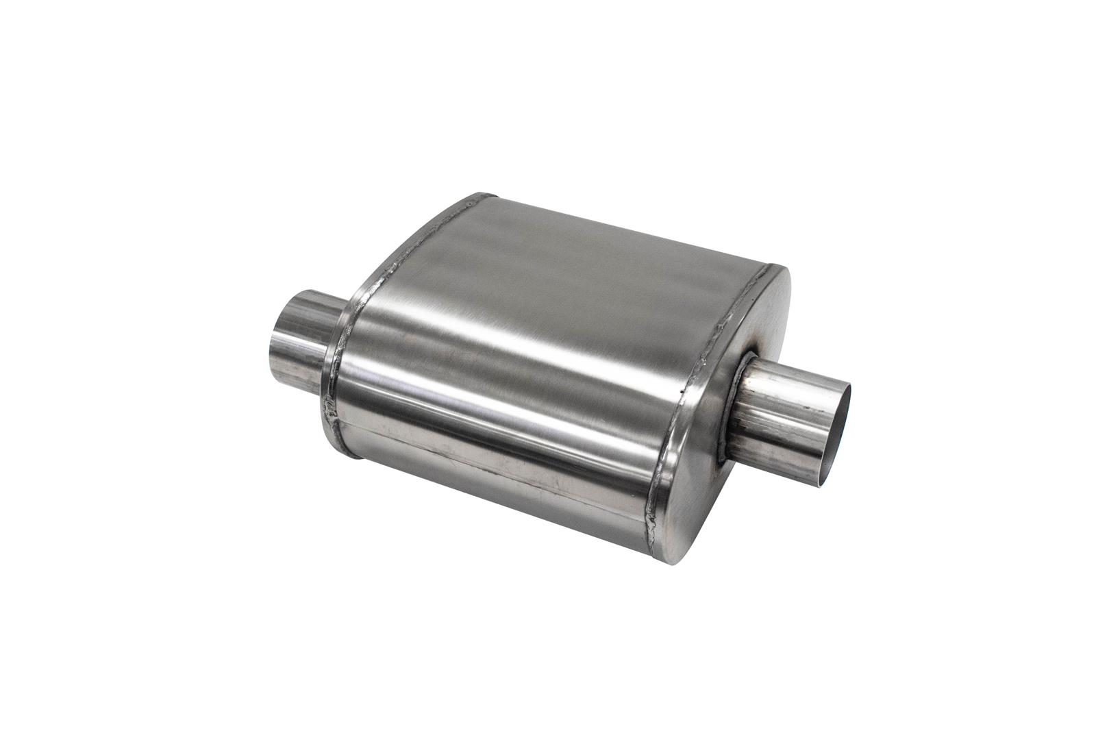

Yeah, I hear you on the muffler delete - very tempting. I do think there will be drone with the muffler delete though. And for me, it is just a little too loud for my tastes and needs (wife, kids, etc). I also drive a 1000 mile trip to Nebraska from Montana several times a year and don't want bad drone during those trips. Have also read that while towing, the drone is bad too on just a delete.
All of which is why I think I will do the Magnaflow muffler swap first. Give it a few months for final break in of the Magnaflow. In the YT clips I have heard, the Magnaflow was about what I want the truck to sound like for my personal needs and tastes. Will probably only cost $100 for the Magnaflow muffler, so not much more than the delete.
When you delete yours, please post sound clips and your experience with drone. Very interested in your experience with the delete.
Also if you find a fix for your TPMS sensor issue, please post that also. I will do the same on my end on both the muffler and TPMS issue if I have any updates.

I think your right, might be best to put some sort of drone canceling muffler in there rather then just a muffler delete.
‘I am a Corsa guy, so I ordered Corsa pro series muffler from Summit racing tonight. Supposed to be here by Thursday my muffler shop appointment is setup for Friday morning. What are your thoughts on the flapper, keep it or delete it?
part number CSE-CP300CT
Nice! Yeah, I watched that YT video. It sounds really good to me.
I do think a muffler swap is the best option. Really depends on the tone and sound one wants. There are lots of choices to choose from, so watching a bunch of YT videos of these trucks with different set ups for mufflers is the best bet in choosing.
Let us know how it sounds when you are done! I'm going to my muffler shop to see about ordering a Magnaflow tomorrrow. I could do the work myself, but it really isn't worth my time to do it. I won't cost much to have it done.
I will probably keep my flapper valve in. If I don't like it, It isn't hard to wire it open and hold it with some C clamps. That way it is still there if one wants to release it back to working instead of open.
