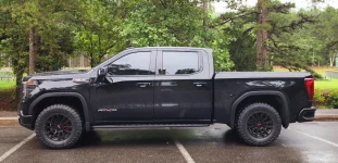

Can you post some pics?
Here ya go! If you ”flip” the block to top of axle, you can use same factory u bolts. Did mine almost a year ago
