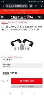

Cool thank you! Interesting that you put those bolts that way instead of reverse which would make more space under CV. I have a '21 with the 6.2 gas, so I would guess that's lighter than the diesel. Thanks for the pics, and the idea of the RAS. I didn't know that the RAS changed the height. I may consider that. So I will definitely go with a bottom spacer now and feel safe about clearance. Approximately how thick is that lower spacer? I found one that advertises a 1"lift, but it's not a 1 to 1 ratio due to geometry. The actual size of the piece isn't listed but does this pic look comparable in thickness to the one that comes in the Readylift kit?
Edit: I missed you saying you also have the 6.2. Oops! Oh and I have one more question too. Do you have any issues using 4wd Auto?
