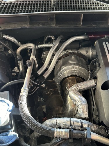

Some information on this kit that I figured someone might find useful.
Oil catch can location: the location of this catch can works on all 2019-current vehicles (1500 Sierra, 1500 Silverado, Tahoe, Suburban, Yukon, and Escalade) that came out of factory with a 3.0 Duramax engine (LM2 and LZ0). The location also keeps the catch can and lines from freezing in cold weather.
Hardlines: provide better longevity under heat. The route of hardlines over the turbo/exhaust prevents the possibility of condensation build up within the lines.
AN fittings: provide a better seal, better longevity over hose and clamps, along a fittings with it being more appealing.
Looking for two of these setups, both my wife and I run LM2s and I was about to pull the trigger on PPE. I'd prefer a more accessible design. If we add the PPE intercooler, will that become an issue with space is my only concern.

As far as I’m aware this kit will not interfere with a PPE intercooler setup.
