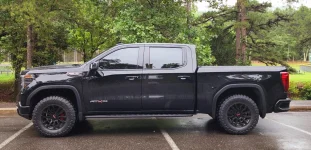

2023 AT4 -To level or not to level
Resized_20220821_145847.webpResized_20220821_152730_202233548505873.webpResized_20220821_152654_202250007269565.webp

My vote is not to level. I leveled my last one and disliked it so much that I installed larger rear blocks to put a rake back in it. Reason is, to my eye the level truck with anything in the back or a full tank of gas looked squatty depending on the elevation it was parked at. It sounds weird but I am weird about my trucks. It’s gotta be right and I can’t stand squatted trucks.
Hey guys new to the forum here. Just put on the level kit from RC 1.75". Also switched out the Wrangler Tires it came with. Added Nitto ridge grapplers 295/60/R20 HUGE improvement. Quiet by a ton. Gained 3" and some change on each side in the front with the kit and tires. Gained about 1" in back. Truck stance is now BEAST MODE !
Hey man can you post pics? I have an at4x AEV and just bought readylift 1.75” kit and LT305/70R18 E120/117R RECON 34.8. Install is week of 18th.
