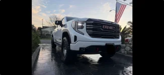

Zero offset
1.75” leveling kit
285/65/20
