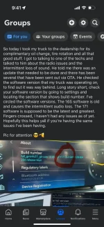

I don’t have the 3.0, so I cannot speak directly for it from a personal standpoint - but I’ve had my truck (6.2L) for 13 months, and just crossed over 11K miles yesterday. The only issue I’ve had with mine is the infotainment system likes to mute itself 2-3 times in the first couple minutes of turning the truck on for 1-2 seconds each time. I do want to make an appointment to have my transmission checked out, because it has started to randomly “clunk” when I put it into Park. Used to be that I’d put it into P and you couldn’t hear or feel any movement in the transmission - and my wife has a 2023 Tahoe with the same exact engine and trans, and it’s silent/motionless when going into P… but now my truck makes a noticeable noise and has a thud motion when I put it into P.

For the audio issue, you need to tell the dealer you need them to do a software update to the version that includes a "build number" that has Y171.X in it, instead of Y165.X. See screenshot of someone posting this about their refresh chevy. This fixed my issue on my AT4!

Thanks! It’s at the dealership now for the transmission issues… so I will call them up and ask them to do that as well.
