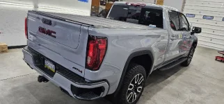

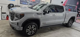

I just picked mine up from being ceramic coated yesterday. Most ceramic's should last several years, with some maintenance. Some detailers recommend bringing it back every year for a "touch up." I just use a spray on, wipe off sealant every 6 months. Obviously environment plays a big factor. My garage kept C7 should see 5-7 years from the coating whereas my AT4 that sits outside 365 days a year probably will not.
