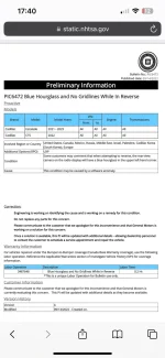

How do I look this up for my vehicle? Just picked up an acadia AT4 and think it's missing the front park assist sensors.
Welcome.
You will have 4, 1" circles in the bumper. Usually same color as bumper unless chrome.
I have them in the back but think they could be missing front front and should be there. How would I verify if they should have been part of the build. Seems odd they have 1 but not the other.
It will be called out on the window sticker under Options and Pricing...
