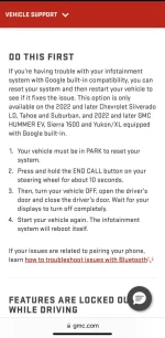

Hey someone on here posted this tip in another thread related to CarPlay issues. Maybe you try this before heading to the dealer? Who knows, it may also make your buttons come to life!
