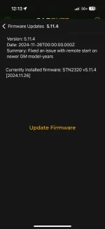

With the App, I did a factory reset for the Carbyte and unplugged and plugged it back in again.
Also did a firmware update check, which looks like it is already using the latest.
The engine still stopped and I ended up just manually pushing the OEM button on the dash to disable start/stop

With the App, I did a factory reset and unplugged and plugged it back in again.
Also did a firmware update check.
Engine still stopped and I ended up just manually pushing the disable button on the dash
