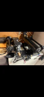

How many horns do you want? You can install a single/double horn setup without the tire delete. The sound isn’t as loud but it is a lot louder than stock. I have a single horn installed behind my grill. Took about an hour once I found a spot. It has a much smaller air compressor so there are more install locations. Draw about 16-18amps so easy to add a relay or wire to a gang switch.
Agree, I would rather not loose the spare tire as well. Lots of room behind the grill for horns or trumpets. I installed 2 pairs of PIAA super Bass horns behind the grill sounds like similar to you.

Sounds like a great deal! Do you have any photos by chance? I get blown up on here with, if there are no pics it didn't happen..... I believe you but I would like to see what a 5G Spare Tire Delete is and how it looks installed.. And since we are talking about a horn we might need a sound clip..... Thank you in advance!!!
OK that awesome! That looks like the same kit I have, Do you know if you used the 4 long "foot" bolts with the rubber on the end? I was looking under there and not sure what I would be able to make contact with when cranked up all the way.. Looks like yours is just cranked up to the top of the mount to frame parts that the spare tire would normally touch. Looks good, I like that you can barely see it from the back. What switch did you use or is it wired up to you steering wheel horn? Thx again!
its the switch that came with it
the guy said he didn't trust the cables or crank so he bolted it
so i wouldn't loose it going down a bumpy road
