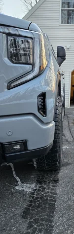

Just purchased a 2025 AT4X, I plan to run the stock wheels and tires until a new set of tires are needed. I want to push the wheels out about 1.5". When you added your 1.5" spacers, did you have to do any cutting to the wheel liner due to rubbing? or did you not have any rubbing?

If you go with aftermarket wheels you can achieve the same look without spacers by changing the offset. That's what I did. I went with 1/2" wider tires and changed the offset from the factory +28 to a 0 offset and have almost 1.5" poke.
I'm not sure if the AT4X has the same offset as the regular AT4.

What size tire?
I have 285/65/20 and I’m scared if I add spacers I will have run. I do have it leveled in the front and a 2-1/2” block in the rear to keep me level or maybe a 1/2” of rack.
I had run 295/65/20 and only minimal rub, only when 4 adults.
