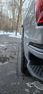

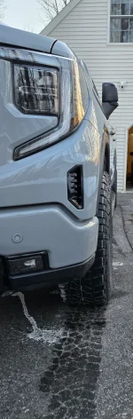

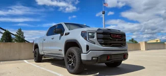

It depends on the look you're going for. I wanted to keep the stock 20's, not do any lift/level and did not want to do any trimming. I took a chance on 275/60/20 with 0 offset wheels. I love the fit. That gives me a slight poke past the fender but I did have to remove the metal mud flap bracket because I did get a slight rub at full lock in reverse. I was able to keep the short factory "mudflaps" if that's what you want to call them.

Can you send a photo?

What if I went 0 offset? Not really understanding what that does.

Wheel offset is how far the mounting surface of the rim is from the outside face of the wheel.
So for example, the stock offset for the AT4 with 20" wheels is +28, so that means the wheel is going to sit just inside the fender. As you can see above with my 0 offset, the wheels sit just outside the fender. The more negative offset you go, the farther "poke" you're going to get out past the fender.
