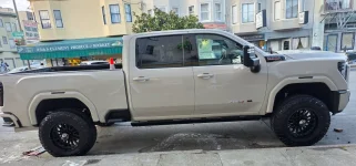

What have I not done is more the question.... Didn't even have 50 miles on it before I ripped out all the running gear and re-did everything.
From the top:
Kryptonite ultimate front end kit,
Fox 2.5 HTO front and rear
Sulastic rear shackles
kryptonite steering stabilizer kit with fox ifp stabilizer
lights out the wazoo
dual viair 485c compressors stealth behind step sides
7 gallon manchester asme air tank stashed in the hollow between drive shaft and truck bed (yep, dropped the drive shaft for that one)
Nathan airchime K5LA stealth where rear tire used to beall 10an lines and fittings
Graham white manual metering valve where my trailer brake control used to be as I cut it out and fabbed a custom cherry wood mount for it (don't even ask me about the nightmare it was to get 10 an lines in and out to the graham white valve under my center console so I can have the metering valve right next to my cup holder)
banks pm and Derringer HO
300 amp hour lithium off a redarc bcdc1240
etc etc etc.....
Did I mention I still don't even have 750 miles on this thing yet? I kind of took the first two months of the year off and just dicked with the truck the whole time lol. Yes there are a million more photos and I did not think it appropriate for my first post to photobomb the forum but feel free to ask any questions I'll add pictures as they become relevant.
Thanks for having me and excited to be here!!!
