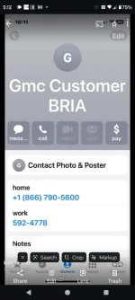

Try this number. I've seen a lot of people contacting her and getting answers and results. I hope she can help you out. 🙏🏻
