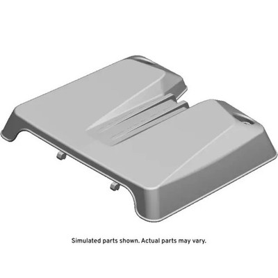

Anyone have the part numbers for the cover and other parts needed? Thanks in advance!
I have looked at a few online sites and went to my dealer. The best price are definitely online. I know there are several parts that you need to get. The cover comes with some, and some will have to be ordered separate. I am going to order everything in a couple of weeks. I will post everything when I get it. Including where I got it, all parts, install, and total price. The part you need is from the 2025 as the 2026 Canyon does not list one. If you are wanting to order now, let me know and I will get the # that I have, I just don't have them with me now.
Here is part 1, comes with parts 2-5.
Will need part 8, not sure on parts 6 & 7.

I ordered my Top Engine Cover ( part #12737532) for my '26 from World Parts Direct on March 5 and received through USPS on March 12. Total cost $69.28 including shipping from Texas to Iowa. It is a genuine GM product. Everything for the install was included except for the 2 (6MM X 1.00 X 25MM) bolts that secure it to the motor. I went to my local Menards and purchased them in SS, for under $2.00 for the pair. Install was easy and I think it looks so much better. The parts that came with it were already installed on the cover, all I had to do was snap the 2 insulators (part 5 in post above) to part 8, which is on your motor already. I ended up adding 1/4 inch washers to my bolts to compress the rubber bushings and hold it on solid. The only tools you need are a 10MM socket and ratchet. Any questions feel free to ask. I an not affiliated with World Parts Direct but they were nice on the phone and helped me out. Hope this helps.
Cover came today and it was a 15 minute install with the additional purchased SS bolts and washers. I did insert a small rubber o-ring between the washer and the cover before tightening the bolt.
Note: The site indicated this cover part will not fit the 26 Canyon. World Parts actually sent me an email advising me of same and that any returns are subject to their return policy. I responded that the part came recommended via the forum and does fit. I also sent them a pic of the installed cover as shown below.
Big improvement! Thanks nextyear58!!
