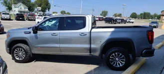

And photo of the truck at the dealership prior to pickup (just because):
