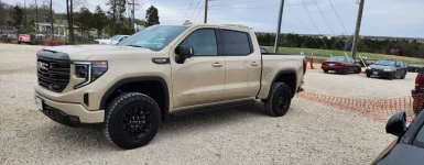

Monday 4/10/22 - Took delivery last Thursday and was very happy with my new truck, it had 8 miles on the odometer. After getting on the highway at speeds around and above 60mph I noticed a bad vibration coming from the bottom of my seat which permeated throughout the entire truck. I checked the air pressure and also checked to make sure I had not "thrown" a weight from the wheels. Everything checked out. I took it back to the dealer today and explained to them what I was experiencing. I thought they would simply rebalance the tires and I would be back on the road and on my way to my tint shop. At this particular dealership, they have a glass overview of the mechanic shop so I watched the tech pull my truck in and then back out for a test drive which gave me the idea of using the MyGMC app to track where he was driving the truck. I noticed that he didn't take it on the highway which is where the vibration is most noticeable. The tech came back after about a 15-minute drive and I promptly left the waiting area and went to the counter so I could listen in on what he would say to my service advisor as he did not know me to be the owner of the truck he just drove. To my surprise, he comes right in and blurts out to the SA that he believes that the truck has flat spots in all 4 tires. He goes on to say that the truck shakes pretty bad and that he had dealt with another truck last week with the same issue but wasn't as bad as mine. The SA asked if the truck is driven more would it work itself out (my truck only has about 250mi on it now)? The tech said that he didn't think so, he referenced a GM bulletin which states that after a certain amount of time, the flat spots become permanent. They then looked up my VIN and confirmed that the truck had sat on a Detroit holding lot for approx. 8-9 months waiting for missing chips. The SA then mentioned to me that I needed to drive the truck to at least 1,000 miles before GM would do anything per GM policy. I told him I was not comfortable doing that as the truck was giving me a literal headache when I took it up to highway speeds. He suggested that perhaps they could drive it to 1,000 miles for me, I said I do not agree to that either. Eventually, they put me in a loaner and are trying to figure out how to resolve this issue.
I wanted to let others know about this as I had another brand new car that I purchased last year for my rental fleet that was doing the same thing and the dealer rebalanced the tires 3 times which did not completely resolve the issue. Both vehicles were high-end models and both sat while waiting for chips. Just want others to be aware as it's pretty easy to check approx. how long your car/truck has been "sitting" by looking at the MF date and comparing it to the actual delivery date. I think this is a lesson learned for me regarding low-mileage vehicles that perhaps the average person wouldn't always think of. To the dealer's credit, they admitted that the truck shouldn't ride like it was and they didn't try to make me feel like it was all a figment of my imagination. That said, they are trying to figure out if GM is going to cover the cost of the tires or the dealership. I have my thoughts but I have decided to see what happens.
I will provide an update once it is resolved.
Updated: The dealer paid for new tires. I opted to go with Nitto's and wow what a difference! Don't recommend the stock tires at all.
