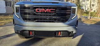

Anyone know what's involved in replacing the lower "valance" on the front bumpers? I assume the entire front clip needs to come off.
Update:

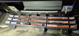

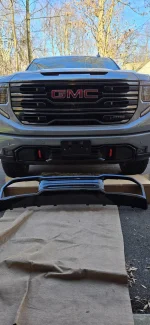

I decided to just give it a go and I found it's pretty easy. It's held on by a series of 14 7mm screws with the washers attached. All are fairly easy to reach and I could get them with a small swivel head ratchet wrench and extended socket wrench. When you're under the truck it's going to look like there are dozens of hard to reach screws to take out, that's not the case. Once you have all 14 screws out, just reach your fingers through the grill looking plastic on the backside and push the lower valance and it'll pop out. Set the new valance back in place, reattach all 14 screws and you're done. I've attached pictures to try and explain. The only reason I replaced it was because the dealer pop riveted the front license plate bracket to the lower valance and my state doesn't require a front plate.
I bought the part on 404parts.com and had it in about 5 days. Factory part for $200, I didn't think that was terrible.

I just changed out my Denali grille to a blacked-out grille today. The lower valance or whatever they call it is as expensive as the main grill. Since its low and no one really sees it, I wanted to just paint it. I've been searching You Tube for a video on removal. It just so happens that I wanted to paint it tomorrow. This was perfect timing.
I'm going to add one important note. I pulled the lower valance today. I only found 13 bolts and it wouldn't come loose on the passenger side. I couldn't see it, but I finally felt the 14th 7mm screw. It's just to the left of the fog light. It's in between a "V" where two pieces of metal frame meet. I had to pull the fog light to get easier access. I think when Leo581 posted on how to remove it, he had pulled the fog lights to install the new Diode Dynamic lights. The other 13 screws are very visible, but that 14th one is a pain.
I painted the lower valance today. A black lower valance was as expensive as the much larger and more complex upper grille. Since its low and really not that prominent, I decided to just rattle can it. Got the black on today and will clear it tomorrow.
