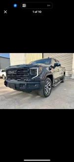

After looking at one close, looks like the plastic piece around the headlight and wheel mold needs changed, then you can bolt the AEV bumper up. Might be too much of a pain though. Im sure there will be a very comparable aftermarket bumper soon though. Atbthe very least, I'd like to have the winch...
I may be the only person on the forum but I absolutely prefer the non-AEV bumper and front-end.
I wish my 23 AT4X (build date late Nov 22 I believe) had the AEV bumpers, but I actually like the front non-AEV bumper look better. Still would like to have the AEV bumpers, but probably not for 3 or 4 grand or however much more they are asking for them. As a contractor, it would be nice to have the heavier duty bumpers, though. Then again as a contractor, I should probably have an AT4 HD.
Sadly that parts manager is correct, I have a buddy that wanted to do it, it's not just the grille and upper plastic pieces of the bumper its also the front fenders they are about 1.5 inches wider than the pre-AEV style front end, so sadly in order to do it you are talking 7 ish grand just for the front not to mention the back bumper which would be about 3 grand also, I think GM should've just come out with the AEV bumper or some other more offroad capable front bumper to begin with like the ZR2 did
looks amazing,,,,, any chance you have a parts list and an idea on how hard it was ? I would love to do this
