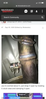

Yeah, I can hear the flap rattling, but only from the outside. It’s not bad, but sometimes I can be ocd about things like that. If I grab the spring or put my foot on it, the rattling stops.
Well maybe you should try this before you cut it out, just to see if ya like it.
