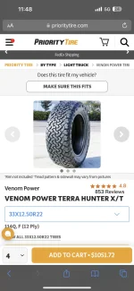

Got a few questions I’m hoping you guys can help with. Got 21 AT4. Looking at a ReadyLift leveling kit with upper controls arms. I know stock wheels with 12.50 wide tires and no wheel spacers, the tires will rub the upper control arms.
Can I clear the upper control arms with a 33x12.50x22 wheel/tire with a 10” wide wheel -19 offset and no wheel spacers? With how much room to spare?
I’d love to see 22” x 10” wheels and 33s” with -19/-24 offset. Ever more so the Tis Off-road 547BM
Tires, does anyone have any first hand experience with Venom Power Terra Hunter X/Ts? Id like to hear the good or bad

Holy cow. Are you sure you want to run F rated tires on you 1500?
If you load heavy all the time like on the farm, there is nothing wrong with F's on a 1/2ton. But you will feel every expansion joint on asphalt, empty.
For a smooth ride, just a D would suffice. What rating are yours now? I know the '21 1500 Denali had 22" D's.
