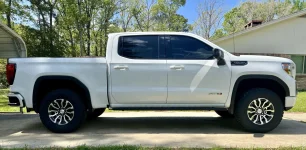

Happy with the outcome / stance by doing just the 1.75” ReadyLift & UCA’s. Went with LT295/70-18 Nitto Recons & 1.25” BORA spacers, with some trimming.

Beautiful truck! Do you need to have a negative offset or could you use the same stock wheels? Thank you.
I went with the 2” level with UCA’s and love it. Plenty of room for larger tires and cost effective. Also, the dealer said it would not void my warranty like a lift would.
That looks great. Do you have any rubbing with the front mudflaps still on. Did you do any trimming.
I did have rubbing. I removed the mudflap bracket and did some trimming. I only rub now on fast right turns into a dip or ramp with 3-4 people in the truck.
