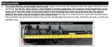

Sweet, I’d love to use the Cognito 110-91207 that you recommended. I run Bilstein 5100s at 1.1” adjustable height, and I’m concerned about the UCA Clearing my stock tires 275/65 R18.
I messaged Cognito and they said as long as the distance from center of the lower eyelet to the mounting face at the top of the strut hat is less than 23.7” it should be compatible. Now I need that specific measurement on an assembled stock AT4 Coilspring and Bilstein 5100 1.1” strut assembly
Reference pictures below:
