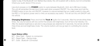

Here is an undocumented feature that I haven't seen before, the ability to change brightness...
