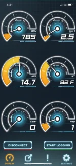

The instructions say you can install the “optional” OBDII sensor for better login. Well, you also need to install it to get the app gauges working!!! They dont tell you that and it’s not listed on the site. So if you want to see the gauges working while using the app ($29) you have to get the wireless connection AND connect the OBDII sensor.

2/26/24 update…
Logged a few passes and threw a check engine light P1101. Sent logs to JB4 to get some assistance. That process of reaching anyone to help you is frustrating to say the least. I’m working with Terry and I think they don’t read the email in whole - he provides half answers or doesn’t directly answer the questions I have. They also respond assuming everyone who uses their product is a tuner - we’re not. The customer support has been the most frustrating experience thus far. I’m feeling like they really didn’t vet this on the 2023 Canyon to be honest.
