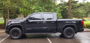

I'm considering replacing the existing 2" rear block with a 1" block. I don't mind a little rake.
Here ya go, my 2022 AT4x. I did just that, flipped the rear axle block to the top (basically removing it, but takes up space in u-bolts). Flipped mine about 9 months ago, no problems, same smooth ride. Those are Toyo 285/70/18 MT’s, no cutting, no rubbing.

Great, thanks for that info
Assume when put load in bed or tow it will sag 2” more than it would with blocks in stock location
Yes, I guess that would be the only negative I have found. I do not put heavy loads in the bed, (have a 3/4 ton farm truck for that) however, I do pull my Can Am Commander 1000 on a tandom axle trailer and it squats some. I had to get a straight hitch instead of 2 in drop to make my trailer sit level. Hope this helps you decision! I recommend it tho
Yes helps alot I will do for sure
I use Sumo Springs in rear on all my previous trucks ( they replace the factory bump stops ) I will install them with a spacer to they maintain same space as when blocks in stock location
Then I expect no more than 1” sag when my car trailer hooked up
