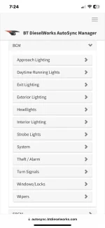

you can buy an Autosync from https://www.btdieselworks.com/ and a BCM license for the autosync for each vin number. I had it on my 2021 3500 and waiting for licenses to be available again for my 2023. They have a ton of features you can change on the BCM. A few are remote start timer to 40min and disable idle shutoff feature.
Most dealers will charge you $250+ to disable just the idle shutoff.

Check my post above. It’s a little more expensive for autosync. The autosync ODB plug is $300 one time purchase and a license is $300 per VIN.

Just buy an Autosync at BTdiesel and a license(when they are available). You can change all the idle times.
