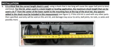

Okay, this is going to be a VERY specific question maybe someone here can answer it for me. I plan to run Bilstein 5100s set to max height of 1.1" on my 2024 GMC Sierra 1500 at4 on stock Wheels and Tires 275/65 R18. I need to know the length from the center of the lower eyelet of the strut to the mounting face at the top of the strut hat. I have attached an example photo below.
The reason for this is I contacted Cognito because I want to ensure that I can run their Upper Control Arms SKU: 110-91207 (UCAs) with the Bilstein's set at 1.1", stock coils, and stock tires on the AT4. Their response to me was "Unfortunately, we don't have a specific experience with the 24-337069 Bilstein 5100s to confirm if it would clear. But our recommendation dictates that the shock should not be any taller than 23.7" front end to end mounting".
I know it is a long shot, but if someone on this forum were to have that specific information or experience with a similar build I would be very grateful!

I’m replying to myself here, but maybe it’ll help someone else out attempting the same setup. The Bilstein 5100s (1.1”) on the stock AT4 Assembly is well within Cognito’s allotted 23.7”
