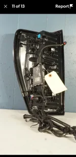

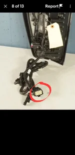

I own a 2023 SLT sierra. I will be installing 2024 2500 tail lights. I will be using the original 2024 tail light harness . I think i Figured it out. Takes some time and extra $.. I'll keep u posted as I go. Pray for me 😬😬🙏🏼🙏🏼
