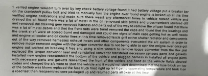

Finally got truck back. Seems to be running good. Here is what was wrong with it …
That is some great detail from the service tech - glad it’s back. Check hoses and gaskets for leaks or issues a couple times over 1000 miles. Hope good stays good and thanks for sharing the detail.
