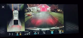

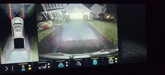

Baja Designs rear lights mounted in the AEV bumper.
